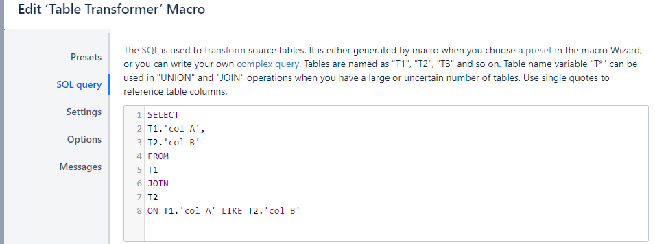

I am merging 2 confluence tables using Table Transformer and only want to display the merged list where the value of Table 1 Column A are contained within the contents of Table 2 Column B. Apologies if this is a really basic question, but have been struggling with this for a while.
Performing the Join is easy enough, just struggling to get my head around the matching
The following is as far as i have got (the original query is more complex but essentially this)
SELECT
T1.'Column A',
T2.'Column B'
FROM
T1
JOIN
T2
ON T1.'Column A' LIKE T2.'Column B'
However this returns no results

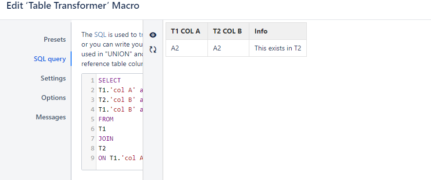

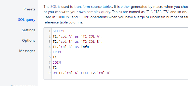

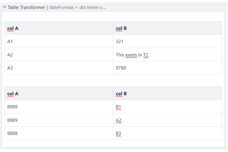

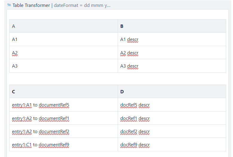

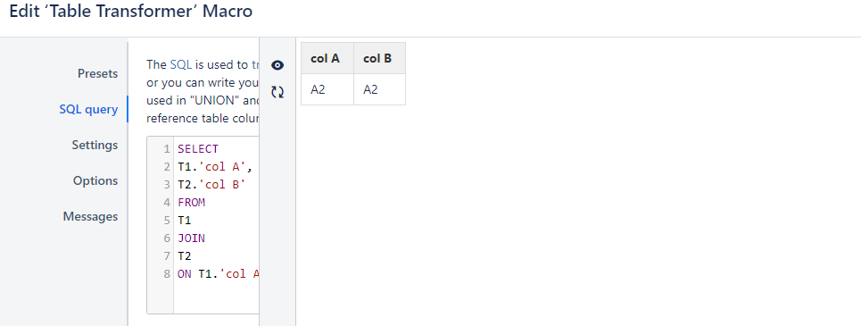

Hi @Craig_Harley , if I understand the question correctly I'm not able to reproduce this error, that means I get values returned when trying this.
I have the following setup.
Result:
Or with some added info:
Are you able to attach some images from your setup? It might help finding the root cause of the problem you experience.
TimK.

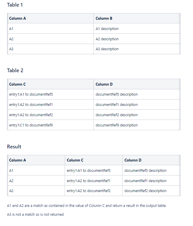

Craig_Harley
November 15, 2023

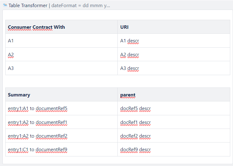

thank for the reply Tim,
this looks identical to what I have done, the only difference being
I would be looking for something along these lines where you have A2 as a like for like match, instead I am trying to do the following
I would be looking to recognise "A2" in T1 Column A as a match for T2 Column B where the value in T2 Column B could be "entry1:A2 to documentRef1", but this would be a match
Can't really post what I have due to the nature of the content, but if needed could mock something up

Craig_Harley
November 15, 2023
Hi Tim, it would be a match as "entry1:A2 to documentRef1" contains A2, apologies if I have been a bit vague
In addition with the format, the field matching would always be directly after the colon ":"

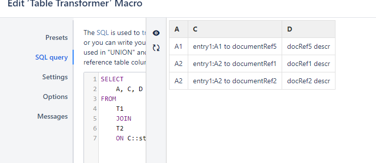

Hi @Craig_Harley, if I have understood the question correctly this example might help
SELECT
A, C, D
FROM
T1
JOIN
T2
ON C::string->split(":")->1::string->split(" ")->0 = A
We here
  • first split the string retunrned from C by ":" and then fetch the second value from the split array which is index 1, hence "->1"
  • then we split the returned string by " " (space) and fecth the left most value which is split index 0, hence "->0"
  • we can then match the result with A in the JOIN ON clause.
Result:
Source:
Hope this helps.
TimK

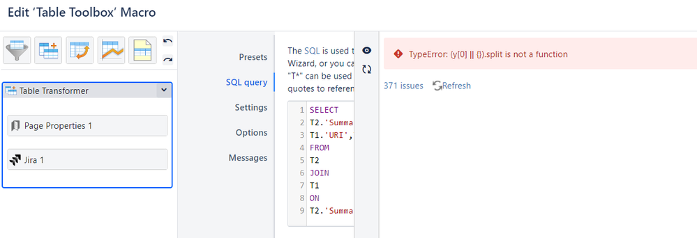

Craig_Harley
November 15, 2023
hi Tim, tried this, but get the following error returned

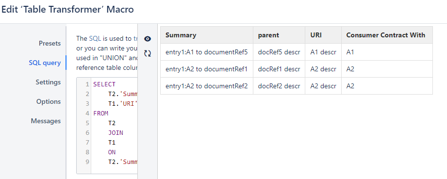

Tim Kopperud
November 16, 2023

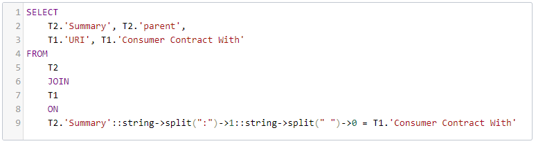

Hi @Craig_Harley, I have tried to exactly match your SQL statement, and it still works fine on my side.
SQL
Source
Result
Where are you getting the error you are refering to?  I would expect the error to be right below the SQL statement as shown below where I here have added a syntax error, but I cannot see this in your attachment.
You might also share an image including the error to understand where it happens.
TimK.

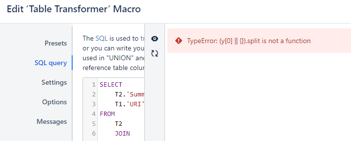

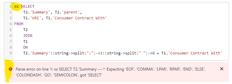

Craig_Harley
November 16, 2023
Hi Tim, the error doesn't show up below the sql statement, but instead appears here
Tim Kopperud

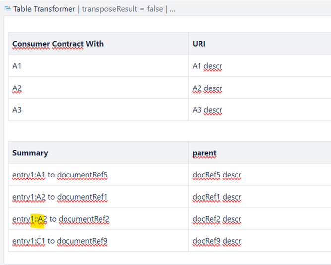

November 16, 2023
Hi @Craig_Harley, I'm able to reproduse this error if I add an extra colon into the Summary column (see yellow marking below).
Error reprodused
Extra colon
I suspect the case is as @Stiltsoft support mentioned earlier, that the table data differ from the example data.
Can you have a closer look into the data set and confirm that the Summary field in each record follows the rule used, as in what you stated earlier:
...the field matching would always be directly after the colon ":"
TimK.

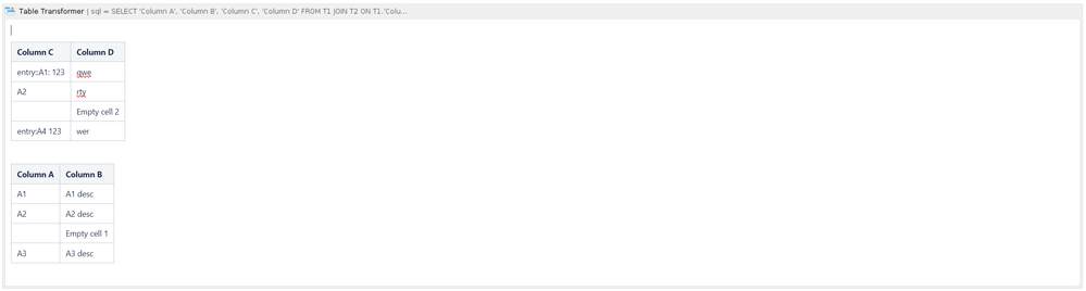

Stiltsoft support
November 16, 2023
Hi @Craig_Harley ,
Maybe this more general option will do for you:
SELECT
'Column A', 'Column B', 'Column C', 'Column D'
FROM T1
JOIN T2 ON T1.'Column C' LIKE "%" + T2.'Column A' + "%"
Like Tim Kopperud likes this
