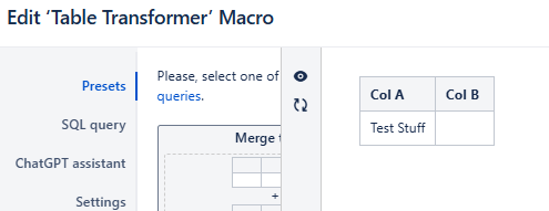

Hello, I have a Chart from Table macro in a cell of my Table (Table 1). This table is inside a Table Transformer macro and will not display the Chart in cell.
Table Transformer v12.1.1 and

The Table Transformer macro gets data from the source table, so to make the charts visible, you need to "draw" them beforehand in the source table.
Go to the Table Transformer macro settings -> Options tab -> Source data and choose the "Show all content" option.
Then you'll get a visible source table with charts and these charts will be also displayed in the output table of the Table Transformer macro.

This works as a workaround, but I then have duplicates of tables that I would prefer to have hidden. I tried using the "Hide Tables" option which I thought would work, but instead results in missing charts again. Is there a solution that would allow me to show just my final table with the chart rendered, and hide all the source tables?

I disagree, everything is not working as expected. There are 3 options for source data:
1) Show all content
2) Hide tables
3) Hide all content
Your statement implies there is no difference between 2) Hide tables and 3) Hide all content.
I also disagree with your statement about best practices. I should be able to render charts in the table, and have them dynamically change position. i.e. I have 10 projects with different due dates, and need to present graphical chart data with those projects. If the dates change, I need to change the order of projects. Using tables transformer, I can dynamically set the order based on due date.
When I select "hide tables" my graphs should still render, but the source tables should be hidden.
The Hide tables option hides source tables.
The Hide all content option hides source tables and additional elements, for example, the refresh button and the number of issues if your source tables are Jira Issues macros.
Here comes the difference between these options.
When you select the Hide tables option, your charts can't be rendered because they are not just plain pictures in the source table but macros based on the nested tables. They should be firstly rendered and become visible. Then the Table Transformer macro gets them from the source table and operates with them.
