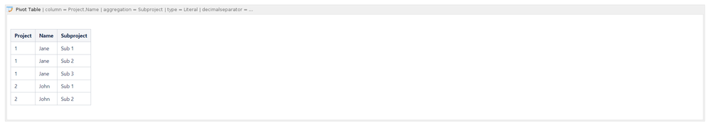

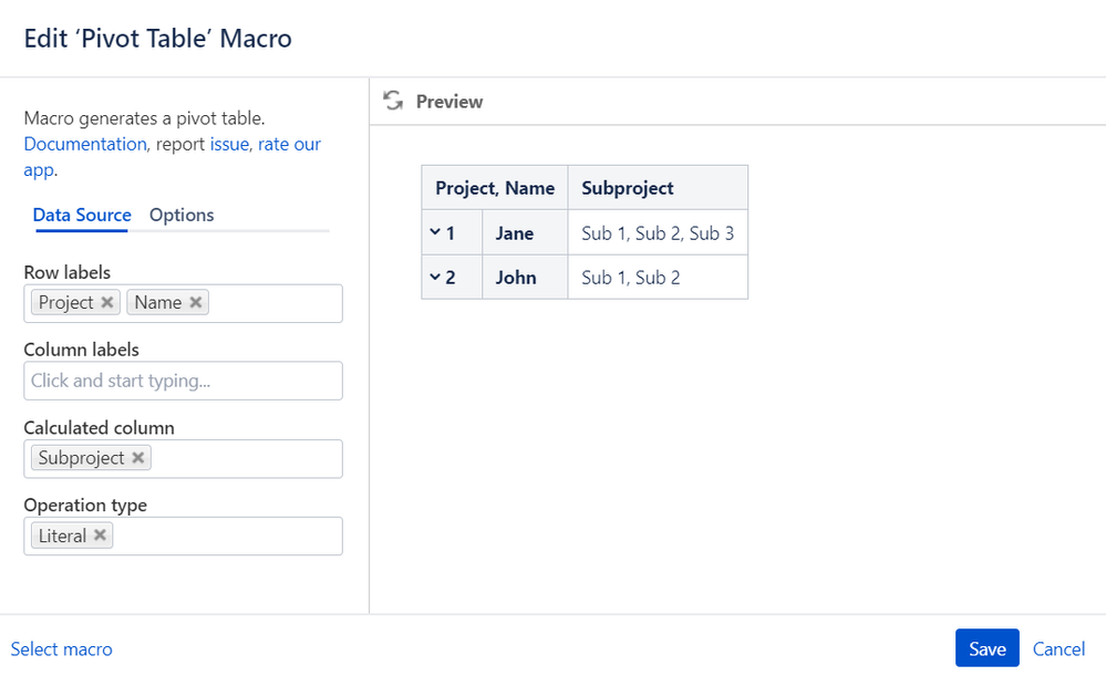

Hi @Richard Moe ,
The simplest way to group your result table is to use the Pivot Table macro.
As you have Cloud, insert the Table Toolbox macro and create the following sequence inside its shell: your Page Properties Report macros <- the Table Transformer macro (to join your tables and/or perform some calculations) <- the Pivot Table macro (to aggregate your data without losing any links).
Here is an example how you may set your Pivot Table macro:
In the Options tab you may select what "Literal value delimiter" you want to use (comma for my example) and hide totals/control panel.
Hope this workaround helps your case.
