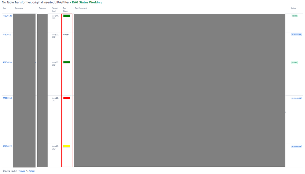

Hi all, I have been looking for a way to constrain the column width of the output of a JIRA issue macro in confluence. This led me to the table transformer macro, which I used by wrapping it over the JIRA issue macro (as shown in the below screen grab) and used the included SQL to define column widths at set values. The issue I came across is that the RAG status no longer displays correctly in this new wrapped format (as highlighted in the below screen grabs). The problem appears and disappears depending on the number of issues being displayed.
I have also included the SQL that I am using at present to set the widths (the output of this is shown in the 'RAG status kind of working' image, where all statuses displaying but are incorrectly set to yellow). An additional issue I have of lower importance but potentially related is that the wrapping of the macro within table transformer removes the link from the 'key' column. If I can have that restored I'd love to know how.

Hi Katerina, thanks so much for your assistance, my issue regarding links is resolved now, much appreciated. Re: the first issue I have triple checked my column naming is correct using autocomplete to no avail. I've been informed that the app version in use is 7.1.9 and I have requested an update.
In the meantime, one last twist in the issue: when I transpose the chart all the RAG statuses show up correctly? This is of course not the layout I am after but nonetheless demonstrates that it is somehow possible.question6.PNG

It's a very strange behavior indeed. If the update doesn't work, please raise a support ticket, attach the Page Storage Format (menu ... -> View Storage Format) and specify your current Confluence version (as I understand, your hosting is Server).
