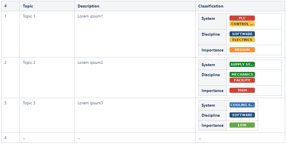

The idea is for customer meetings to keep track of certain topics to mark them with predefined handy statuses. On the one hand, the engineering discipline(s) concerned shall be marked and on the other hand the system(s) involved shall be tagged as well as the urgency/importance.
I have a parent page, where I want to collect & filter the topics of the child pages. For every MoM a new page is created, which includes a Table with action points, description and a column with an extra table in every field, where I want to insert above mentioned handy statuses, that can be hidden. It should look something like this:
Now I would like to just bring together the the different statuses with the Date or topic name and create a large matrix so that I can filter for each System/discipline together or separately, which is something that does not work with e.g. the page property report macro (because then you can filter only for all statuses of one topic e.g. "Software & Electrics" or "Mechanics & Facility", which is sequence dependent as well...)

Our advice would be to use simple tables, we mean without tables inside other table cells or smth.
Like when you start working with Excel, the first rule is to turn your data into a table: columns with headers that contain similar data (only text strings, only dates in the same format and so on). Then you'll be able to perform various calculations, create pivot tables and so on.
The same rule works for Confluence that has very limited tabular options by default.
So, as I see, you have the 'Topic' and 'Description' columns. Now you may add three other columns as 'System', 'Discipline' and 'Importance' and get rid from tables in tables.
Then your statuses may be filtered separately even if there are several statuses in one cell with the help of the Table Filter macro.
To collect your child tables to the parent page and create a combined report, you may use the Table Excerpt/Table Excerpt Include macros.
