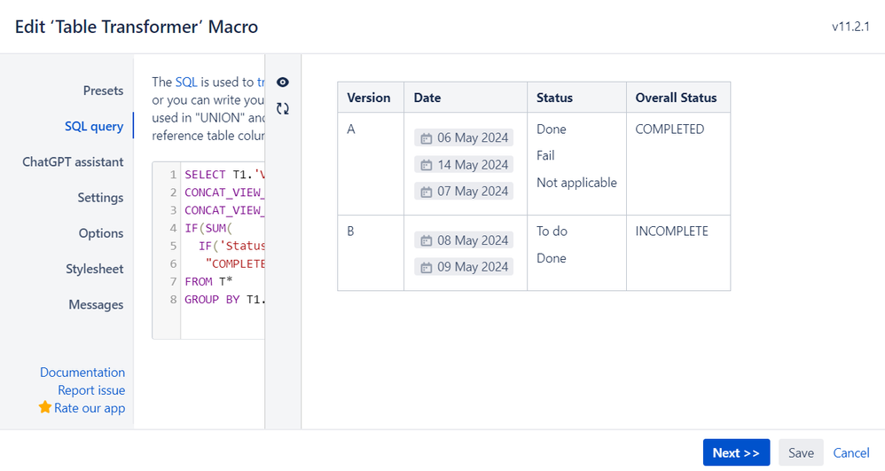

Hi @Aurélien Thazet ,
An update from our developers: if all Done, Failed or Not applicable make COMPLETED and any other status makes INCOMPLETE, you may combine your first query and the second query in one Table Transformer macro:
SELECT T1.'Version',
CONCAT_VIEW_AGGR(FORMATWIKI('Date' , " \n")) AS 'Date',
CONCAT_VIEW_AGGR(FORMATWIKI('Status' , " \n")) AS 'Status',
IF(SUM(
IF('Status' = "Done" OR 'Status' = "Fail" OR 'Status' = "Not applicable", 0, 1)) = 0,
"COMPLETED", "INCOMPLETE") AS 'Overall Status'
FROM T*
GROUP BY T1.'Version'
The variant
IF(SUM(
IF('Status' IN ("Done", "Fail", "Not applicable")), 0, 1) = 0,
FROM T*
is even slightly shorter but gives the same result (the IF function was rewritten in a more elegant way).
Aurélien Thazet
May 27, 2024
I spent a whole day trying to find a solution. It works like a charm, thank you very much!
