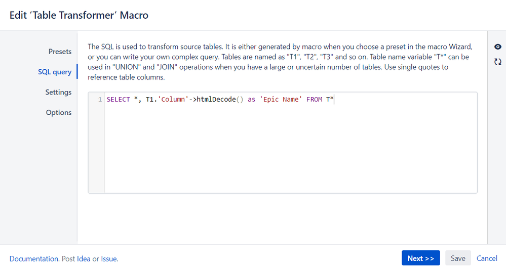

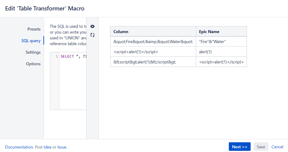

The query for the Table Transformer macro:
SELECT *, T1.'Column'->htmlDecode() as 'Epic Name' FROM T*
Hope this workaround may be helpful.
Thanks @Katerina Kovriga _Stiltsoft_ ! This is a nice solution! I set it up as a global user macro since html macro is not enabled in our instance.
