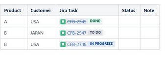

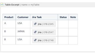

In the below table, "Jira Task" column uses Jira macro to pull the info. Now how do I retrieve the status string (DONE/TO DO/IN PROGRESS) from "Jira Task" column and fill in the "Status" column? I assume I can use table transformer but I'm not sure how to do.
Output to user now, is as below. Expectation is "Status" column should have the jira status string that I can use for further operations and keep "Jira Task" column as it is.

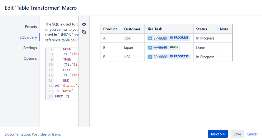

Hi @emagnun ,
You may try the following SQL query:
SELECT T1.'Product', T1.'Customer', T1.'Jira Task',
CASE
WHEN
T1.'Jira Task'->split(" ")->1 LIKE "In"
THEN
(T1.'Jira Task'->split(" ")->1 + " " + T1.'Jira Task'->split(" ")->2)
WHEN
T1.'Jira Task'->split(" ")->1 LIKE "To"
THEN
ELSE
END
AS 'Status',
T1.'Note'
FROM T1
