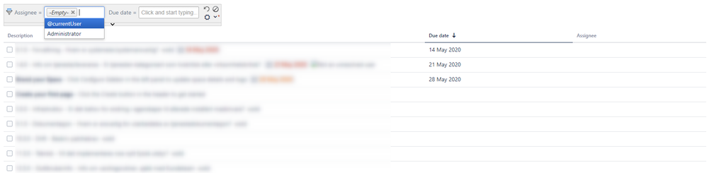

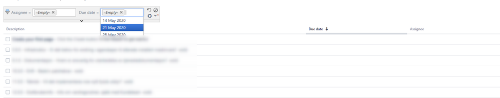

Hello @Marc BEAUFORT,
You can filter the Task Report macro with the Table Filter macro for the empty assignee and/or for the empty due date. Here is an example:

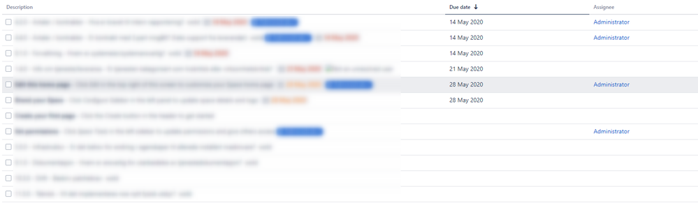

If you can't install it, then the only way I see is to sort the report table by the assignee and due date columns.

My workaround does not necessary help me because ordering by date don't show "without date" on the top (same issue with no assignée).
