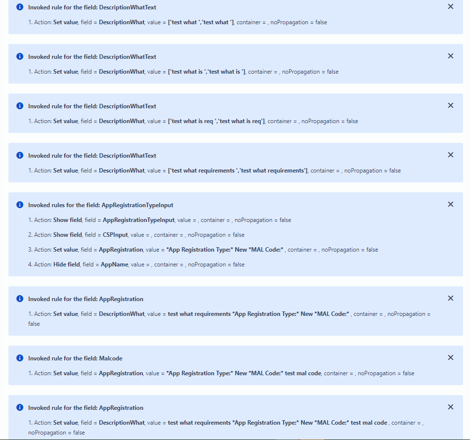

Here is screenshot of a test. There is only one textbox for DescriptionWhatText for user input whose value is then set to DescriptionWhat (Hidden).
I see the value ('test what requirements') being set in bits and pieces. Seems that happens if the user edits the content in that field or clicks out and back in to add more content.
See, what is going on?
You have multiple rules triggering multiple values to be set to the same field at the same time.
Make sure you set the value as text and that it's triggered from one single rule at the same time

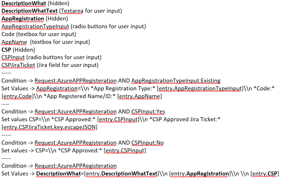

I looked through the form and here is the sequence of fields/actions. The value to the DescriptionWhat hidden field is being set only once at the end. I cant post this as text as this editor complains about format and that I've already posted it but I don't see it. So posting an image
DescriptionWhat (hidden)
DescriptionWhatText (Textarea for user input)
AppRegistration (Hidden)
AppRegistrationTypeInput (radio buttons for user input)
Code (textbox for user input)
AppName (textbox for user input)
CSP (Hidden)
CSPInput (radio buttons for user input)
CSPJiraTicket (Jira field for user input)
Condition -> Request:AzureAPPRegisteration AND AppRegistrationTypeInput:Existing
Set Values -> AppRegistration=\\n *App Registration Type:* [entry.AppRegistrationTypeInput]\\n *Code:* [entry.Code]\\n *App Registered Name/ID:* [entry.AppName]
Condition -> Request:AzureAPPRegisteration AND CSPInput:Yes
Set values CSP=\\n *CSP Approved:* [entry.CSPInput]\\n *CSP Approved Jira Ticket:* [entry.CSPJiraTicket.key.escapeJSON]
Condition -> Request:AzureAPPRegisteration AND CSPInput:No
Set values -> CSP=\\n *CSP Approved:* [entry.CSPInput]
Set Values -> DescriptionWhat=[entry.DescriptionWhatText]\\n [entry.AppRegistration]\\n \\n [entry.CSP]

Hard to advise anything - as you can see the logs show that 2 values are about to be set to the field "DescriptionWhat" and multiple times
