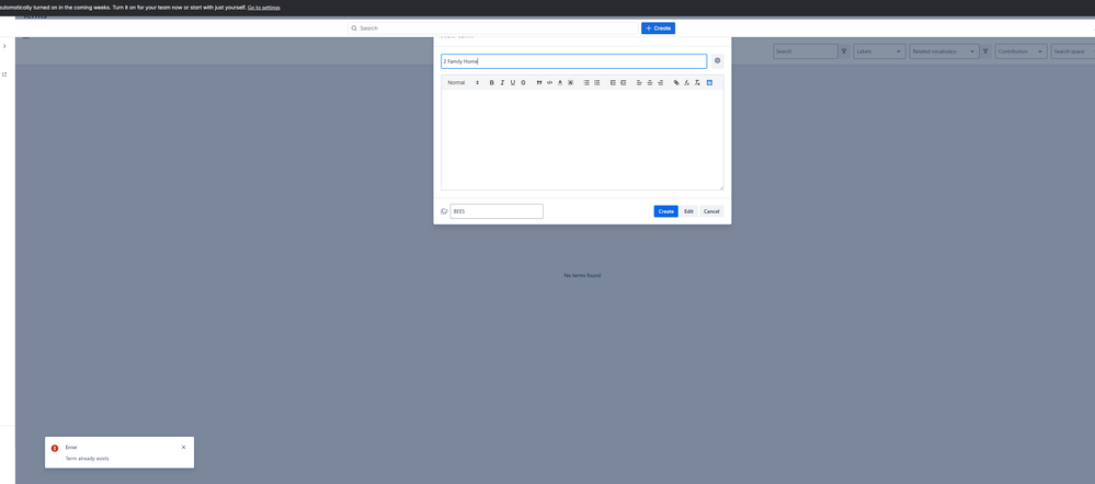

I used Confluence's migration assistant to transfer the data from the local space to the Cloud version, and then installed the Smart Terms app. However, no data is shown in the app. When I try to manually create the same terms as in the local version, it prompts that the terms already exist.
I've tried rebuilding the index from the system setting, but the data still doesn't display. What should I do to make the migrated term data show up in Confluence Cloud? If it can't be displayed, how can I delete that migrated data so that I can migrate by exporting the local data and importing it into the Cloud version?

During migration, terms are carried over with the Confluence pages. If the glossary isn't displaying them correctly, it’s likely an indexing issue. I recommend that you reach out to our support team to further investigate and guide you through the process: https://creativas.atlassian.net/servicedesk/customer/portals
Xiaowen Chen June 5, 2025
Yes, after I contacted Atlassian Support to rebuild the Confluence space index, the data can now be displayed properly. Thanks for your advice!
