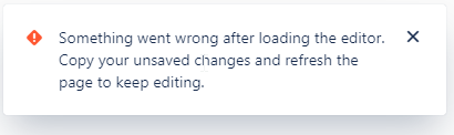

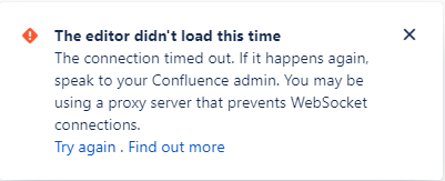

I have this error :
or
when i would like to edit this page , on this space I have another page which works without problem when I want to edit but I have the error above only on one page I tried to make a copy it worked and then 5 min after it works more.
I checked the logs and found nothing.
Do you have an idea ?
Thanks in advance
Hi @Salim Hammar ,
there are many reasons for this error. Please take a look to the following troubleshooting article https://confluence.atlassian.com/confkb/confluence-throws-the-editor-didn-t-load-this-time-error-when-trying-to-edit-a-page-840796639.html
Hope this helps,
Fabio
hey @Salim Hammar , first of all try to disable collaborative editing. If your issue persists please take a look to the article provided in my previous comment.
Yes but when i disable the "collaborative editing" i don't can edit any page ?
Try to disable collaborative editing and verify if you cn edit pages (collaborative editing doesn't turn off page edit)
