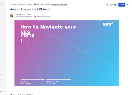

Maria Martinez
September 9, 2019
I hope this is not too late, I think I had the solution:
1.- Create the page where you want the pdf or powerpoint to show
2.- SAVE THE PAGE
3.- Insert/attach the file (pdf/powerpoint)
4.- Highlight the file and click the + Insert macro symbol
5.- Click Other Macros and search for the pdf or powerpoint option
This will open the popup of the macro options and it will display the file on the preview section THE ONLY THING YOU CAN DO IS SELECT THE PAGE NAME AND HIT INSERT
It is not going to let you change the size of the file... but at least it will display the document!
