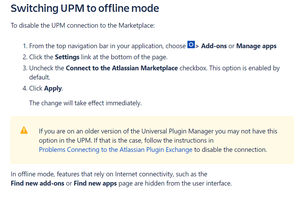

I think the time consumed should be waiting for the timeout of the connection to the marketplace as our service can not access to the Internet.
Would you please help to have a look and advise?
Thanks!
Hi Daniel,
I found an article about disabling the connectivity to the marketplace, and I have disabled it following the instructions.
I will have a look tomorrow whether will it return to the normal state.
