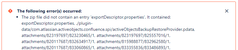

After a few seconds The page is refreshed and I get the following error:
The following error(s) occurred:
As you can see although the error states the file exportDescriptor.properties is missing, it actually does exist in the file.
Unzipping on my win laptop or in Ubuntu also shows the file is existing!

In the logfiles I found information that the unzip process failed because of accessrights. I've mounted <confluence-home>/temp (where the restore process tries to unzip the file) as readonly. In a next log entry I noticed the error that it could not find the file exportDescriptor.properties in the temp folder (which is logical because the previous unzip operation failed...)
So the error in the web frontend about the missing file was misleading and even incorrect! (cost me more than a day)
After mounting the temp folder as read-write everything work smoothly
I would suggest to improve the errorhandling and report to the web frontend already that the unzip operation failed.
