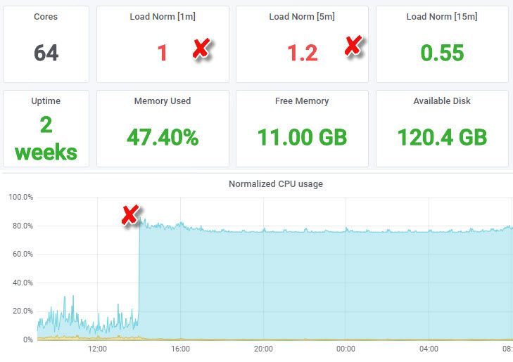

This morning, a Confluence process is currently consuming over 75% of the overall CPU. I am not sure if this is related. We plan to restart the Confluence service at 8PM tonight as long as the CPU stays around 80%.

Cores are stressed as well:
