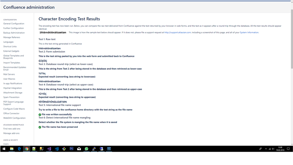

I'm using confluence server 6.7 and installed it using UTF8. document content seems fine but I'm having problems in Space Name and Page Titles. Typing the character "Ş" but getting "?" instead. I tried few ways to overcome but none of them worked for me. charactertest.png

Hello Emre! Thank you for posting your issue here at the Community.
Looking at the results from your encoding test, you might have problems with your *database encoding*.
You may need to fix the collation of your database. You can check further information on how to do it here at https://confluence.atlassian.com/doc/configuring-database-character-encoding-177698.html .
