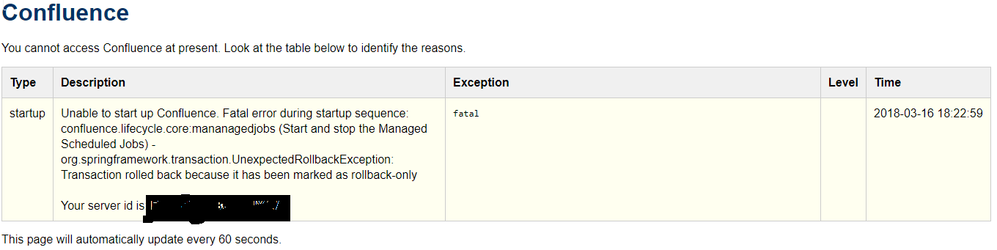

Praveen_Kumar March 15, 2018
You cannot access Confluence at present. Look at the table below to identify the reasons.
Unable to start up Confluence. Fatal error during startup sequence: confluence.lifecycle.core:mananagedjobs (Start and stop the Managed Scheduled Jobs) - org.springframework.transaction.UnexpectedRollbackException: Transaction rolled back because it has been marked as rollback-only
server -id *************
The above error is coming. And in log i didn't see any error like that.
