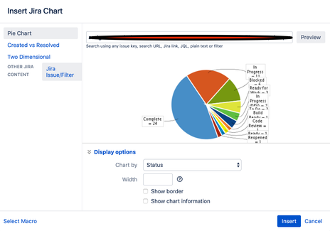

Hi..I am trying to create JIRA pie chart for the total no of tickets by the team in last seven days. I have used the below query to create the chart. The query works fine in JIRA and when I enter the same in Confluence JIRA Pie chart configuration the preview is also displayed correctly.But while saving the Chart is not getting saved. Could you please provide a solution or workaround for the same.
assignee was in (abc, xyz, jkl) during (startOfDay(-7d), startOfDay()) AND (status changed during (startOfDay(-7d), startOfDay()) OR assignee changed during (startOfDay(-7d), startOfDay()))

Hi @[deleted] Thank you for the response. Here I am trying to configure JIRA pie chart in confluence with the below query.
I have attached the screen shot for your reference. While trying to insert this macro the chart is not getting saved.

Some User of our instance, and me to, facing the same issue like describet here.
additional info:
i created on a Confluence page a PiChart with a simple JQL...
"project = KURZ"
and safe my edited Page. in This moment (the pieChart will get the data from jira)
i got an error in the Jira application log
2024-02-26 08:12:52,532+0100 http-nio-8080-exec-1372 url: /rest/mchart/1.0/stats/pieChart; user: jens.semmler@dkb-service.de ERROR jens.semmler@dkb-service.de 492x15157409x2 93uyac 10.142.119.216,127.0.0.1 /rest/mchart/1.0/stats/pieChart [c.a.p.r.c.error.jersey.ThrowableExceptionMapper] Uncaught exception thrown by REST service: com.google.gson.stream.MalformedJsonException: Unterminated string at line 1 column 12 path $[0]
and also this error
2024-02-26 08:00:28,405+0100 http-nio-8080-exec-1350 url: /rest/mchart/1.0/stats/pieChart; user: jens.semmler@dkb-service.de ERROR jens.semmler@dkb-service.de 480x15129491x4 vt7pfc 10.142.119.216,127.0.0.1 /rest/mchart/1.0/stats/pieChart [c.a.p.r.c.error.jersey.ThrowableExceptionMapper] Uncaught exception thrown by REST service: com.google.gson.stream.MalformedJsonException: Unterminated string at line 1 column 11 path $[0]
can you Help?
i i use a stored JQL filter from Jira, it works
