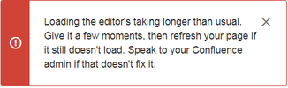

We are currently migrating our Confluence instance from IP to hostname; however, we are unable to edit pages due to this error:
We suspect that it has something to do with Synchrony and its configuration mapping with HAProxy. In our previous IP instance, we used nginx with this configuration:

Everything works fine, but after migrating to HAProxy, even though Confluence is accessible using the DNS, we experienced editing issues as seen in the screenshot above. Our current haproxy.cfg configuration looks like this:
