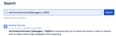

As per my research, I see Confluence doesn't support partial search.
However, I have a use case, where I have no results returned.
Example of exact match search:
Example of partial search of the string that has special characters:
Example of partial search using a wildcard:
Do you have any ideas suggestions?
Thank you in advance!

As I understand, the behavior of searches with the usage of wildcards do not behave as expected.
Since I was able to reliably replicate the behavior you described, I went on to check if bug reports about this existed.
I was able to find this that was raised pretty recently:
The usage of wildcards seems to be ignored and the search looks for exact words, which in turn returns no results after the search.
For example, search for setTimeou* will actually look after the exact match for setTimeou, and nothing else.
