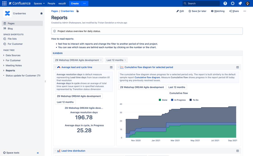

Hi @Sadeesh Narendran ,
If you are a fan of eazyBI and use it for Jira and Confluence reporting, you can publish Jira reports on Confluence pages and allow users to interact with those reports as @Fabian Lim suggested.eazyBI Jira reporst on Confluence pages.png
