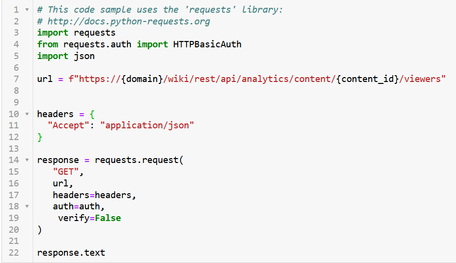

I'm trying to access the page views using the documentation code found here:
https://developer.atlassian.com/cloud/confluence/rest/v1/api-group-analytics/#api-wiki-rest-api-analytics-content-contentid-viewers-get
with intended output:
{"id":15,"count":53}
but when I run the code I get a 404 error
Is there a better way to do this?

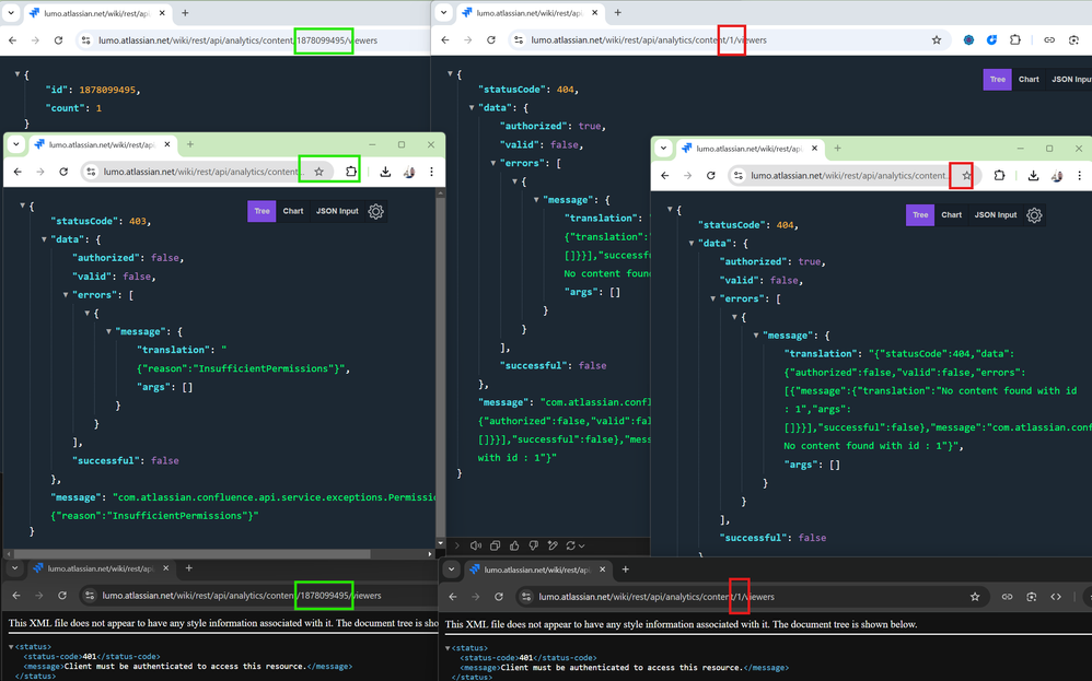

Hi @Craig J , welcome to the Atlassian Community!
Check in browser if the ID is correct, as a 404 error means the resource doesn’t exist.
If the user doesn’t have access, the API will return a 401 error. For content that is restricted, a 403 error will be thrown if the given user (not anonymous) lacks the necessary permissions.
My quick test:
On the left (green box) existing content, on the right not existing with id '1'.
Windows from top: owner of restricted document, other user, at the bottom anonymous user.
Note space is public, but that given page is private
