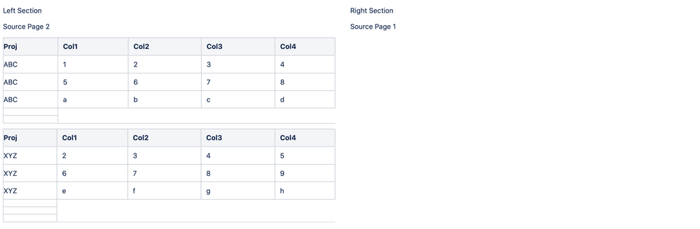

×Hi,
I have a very straightforward requirement - putting 2 excerpt-includes side by side. I am surprised to find that whenever the excerpted data are from tables, it goes to the left of the page, instead of side by side.
Something like this -
(Edit Mode)
(View Mode)
Few key points:
1. This happens only if there is a table in the excerpted element. As evident from the figure, "Source Page 1/2" are text within the same excerpts that contain Tables in the source pages. Text are displayed correctly.
2. I have tried using Page Layout, Section/Column for side-by-side view, but no success.
3. From Macro-side, I have tried almost ALL relevant ones i.e. excerpt-include, Table excerpt include, multi-excerpt include. And, put them in 2 separate sections/columns, page layout sections etc.
No matter what I do, I am not being able to view the excerpted table data side-by-side. Plz help!
P.S. Another weird thing is if I use Table Transformer Macro even in 2 different sections, it seems to combine both the tables based on the Column Name. Isn't the functionality of a Macro supposed to be contained within the section it is called in? How come 2 Macros (both Table Transformer in this case) from 2 different sections are getting merged into one output?

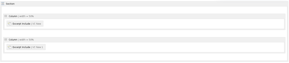

Thanks for the prompt response. However, when I mentioned "No matter what I do", I literally meant it! :P
Anyway, I actually tried with your solution before (didn't send screenshot) and now again. Unfortunately, I see this -
(Edit Mode)
(View Mode)
This is really weird! I can't think of any logical explanation behind this!
Need more help, I suppose! 🤞

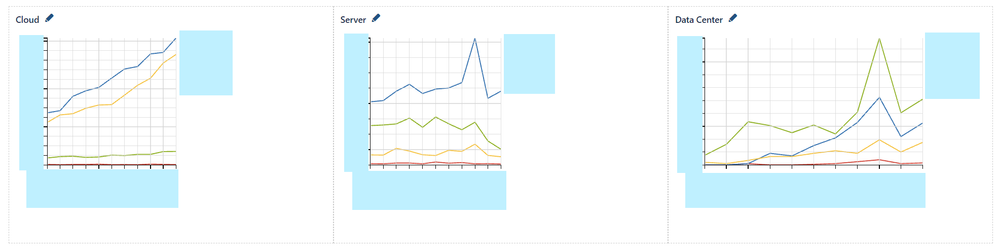

Hi @Abhisek Dey ,
Here is an example of our complex live dashboard:
Edit mode
View mode
As you can see, we have plenty of macros inside the Column macro and everything looks correctly.
Your screenshot shows that even standard Confluence macros (Excerpt Include) don't work properly - maybe something is wrong with the page format? I mean maybe any special apps for custom styles, scripts, etc. can mess up the original layout?
