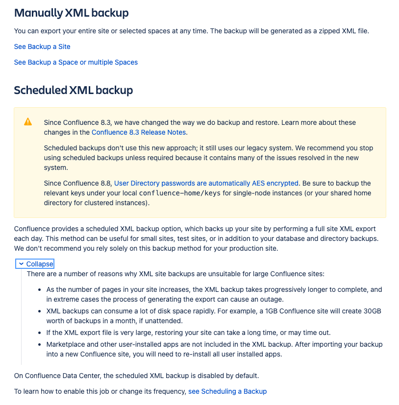

One last question, I keep reading scheduled backups are no longer available for data/server Confluence environment. In addition, scheduled backups are not recommended due to prior bugs and large backups.
I work in a large robust organization, so I plan on conducting full XML backups weekly. Can you give me any advice on this matter?

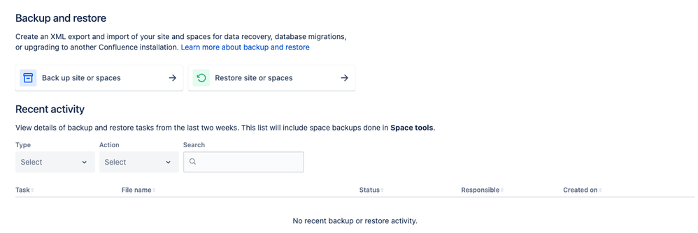

Q: You mentioned backing up my Confluence version 8.6.2 data/server via the supported backup solution for my organizations database. I have an idea of the location, however can you confirm if the attachment below is the right area?
Admin Console> General Configuration> Backup & Restore:
You want to schedule a nightly backup of the underlying DB with the DB backup method. This would be outside of confluence.
