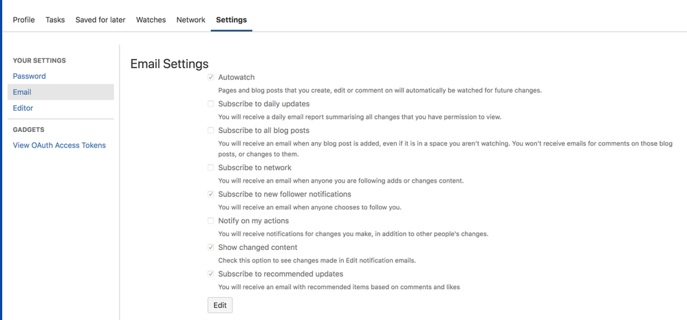

1. As referenced in Confluence Cloud Support documentation, there were E-mail notification settings that users could set to their own preference within their profile. Most people used these settings to STOP being bombarded with email notifications for every change made to a page.
Here's a screenshot of what was PREVIOUSLY there (that has disappeared):
This feature was accessible up until about last week. Now when you look in Profile > Manage Account > there's nothing in the interface allowing you to disable the notifications.  The "email" tab only shows the option to change your email, OR, opt out of Atlassian 'marketing' and no other options.

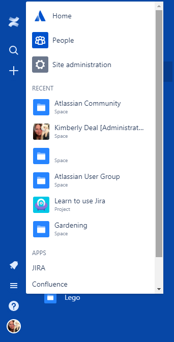

Ok, I've been looking around and with a bit of an assist by @Jack Brickey, I think I may have an answer for you. There are two different areas you can be in when you log in. One is Atlassian Home and one is Confluence. You can tell which you are in by the icon on the upper left. if I am logged into the Atlassian Home or the site admin screens, and I go to "your profile" I have just the behavior you described, The "email" tab only shows the option to change your email, OR, opt out of Atlassian 'marketing' and no other options.
This is Atlassian Home
This is Confluence Home
You can switch between them using the three lines, or 'hamburger' menu. Home at the top and the Apps at the bottom.  Select Confluence.
Make sure you see the Confluence logo at the top of the menu.

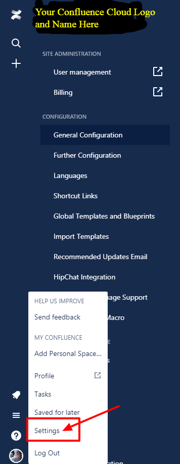

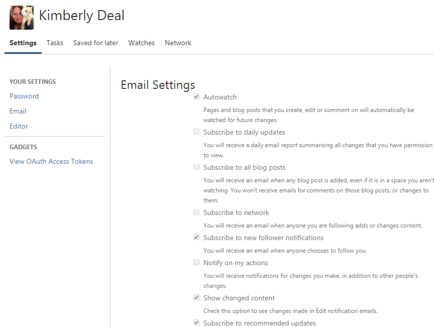

Once you are there, you should be able to follow the standard documentation to change your email setting, manage watches and such.
https://confluence.atlassian.com/confcloud/email-notifications-724765358.html
To edit your email notification settings:
Choose your profile picture at the bottom of the sidebar, then choose Settings
Give this a try and let me know if you see the setting you were originally expecting.

@Kimberly Deal [Columbus AUG] I checked this and getting to this was a bit different. For some reason very circular --- I couldn't seem to get Confluence to open to the General Config page (which is the page you were referencing for the specific "Confluence" link in your steps above) it kept cycling back to my confluence instance landing page.
However, I did find it. Via:
1. 'yourinstancename'.atlassian.net/wiki/admin/viewgeneralconfig.action
2. That takes you to the "General Configuration" page.
3. From there you see the 'settings' option that includes the field with 'notification settings' you can set to preference.
Screenshot (personal info redacted):
Looks like you are in the Configuration area for Confluence, if you drop out to any regular space, you should be able to follow the instructions. A way to tell if you are in the configuration is the dark or deep blue vs bright blue.
I had a real problem getting to this but successful by direct URL to the General Config page. And you are right, the Site Admin page (which from Confluence is the only initial access) is also blue and also has a 'profile' but not the one we were looking for! :)
Thanks again for taking the time to lend a hand. R esolved.
