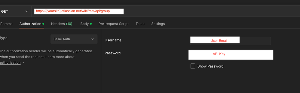

  2. Now that we have an API key for the products, lets hit just the group endpoint with a GET request! I'll be using Postman to demonstrate this.
    1. Open PostMan
      1. Select, GET and Enter the API endpoint url: https://[yoursite].atlassian.net/wiki/rest/api/group
        1. Make note to replace "[yoursite]" with the name of your site.
      2. In Postman, under authorization
        1. Select Basic Auth - see [2] - Product REST API Authentication
          1. Enter your email address in the username field
          2. Enter your API Key generated in step 1 in the password field
        2. This should be all we need for now. Go ahead and hit SEND in postman. You should get back a response body with all the groups you have access to on your site.
          1. Nested within the response body should be the ID(s) of all the related groups.
      3. Below, you'll find a de-identified screenshot demonstrating my Postman setup from the instructions above. GetgroupsViaRESTAPI .png
