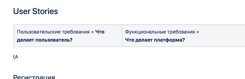

b. Type { and the beginning of the macro name, then select the Anchor macro
I type "{A" but nothing happens.
I attached one another screenshot below, where you can see that after typing "{A" I can not select anything from anywhere.

Ste Wright
December 8, 2019
Hi @Andrey Ponomarenko
If you're seeing Anchor Links next to titles, you're on the new experience. It would also answer why you can't see macros via the "{" - as they're activated by the "/" in the new version.
So, for your questions:
  • On the new experience, you can only use the anchors to titles - click the anchor link to copy it and paste it to use it. If you want to build more customised anchors, you'll need to use a classic page (press to create a new page and just select "Blank Page"
  • Based on comments on the suggestion - see CONFCLOUD-66773 - it would appear it does not work with headers in tables at this stage in the new experience.
  • There appears to be some issues using the header anchor links - see CONFCLOUD-67771
I would advise moving back to the other version if using anchors just for now :)
