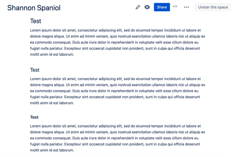

Good morning! Happy to help with this. Are you referring to the headings here?
This is my test page using the new editor, but I am not able to replicate that behavior. Would you be able to show us an example of how it looks on your instance? Have you recently installed any new add-ons?

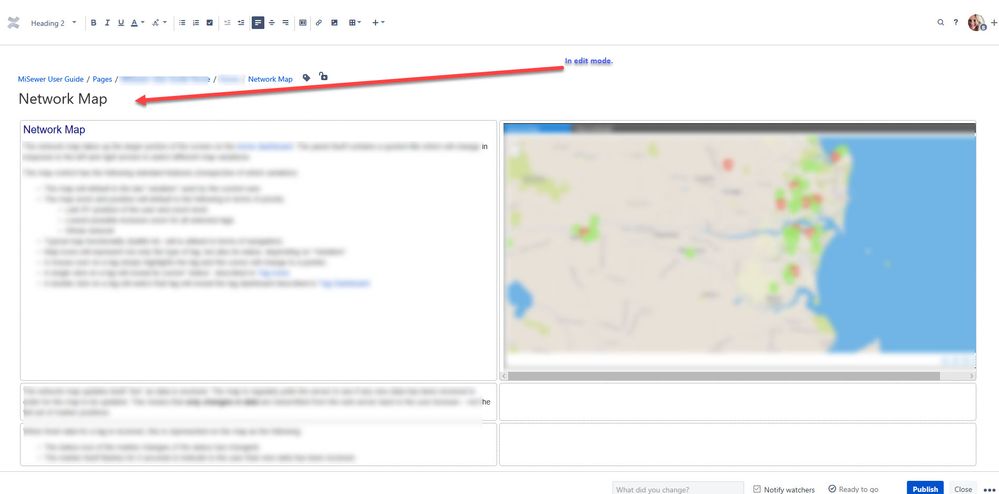

Hi Shannon,
I am referring to the old editor pages - but have replicated the issue in the new editor page too. Maybe I should have been a little clearer - The Tittle of the page is not left aligned in published view. In edit, the Tittle is left aligned.
Also I note, when inserting images I am no longer able to resize and border them?

… Following above - I see now that using the NEW editor I can make the page full width as opposed to fixed width which will move my Tittle to the left as I wanted.
However, We have a lot of old editor formatted pages - where I cannot move the title - there isn't the same "make full width" function to fix up existing pages. Please can you assist?
