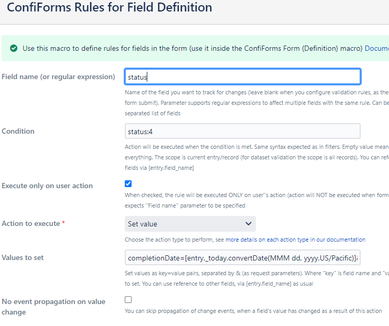

My company is using Confluence Cloud. I created a form using Confiforms with a field named status and another field named completionDate. Using Confiforms Rules for Definition macro, I created a rule such that when the status is changed to "Completed" -- whose key is 4 in the status dropdown-- the completionDate field is automatically set to today's date in the US/Pacific time zone, which is where I am located. I used the convertDate function to force the time zone to Pacific since I will have users whose time zone may be different than mine.
Here's the macro definition:
When I ran it and changed the status to Completed, the completionDate shows with yesterday's date.
Incidentally, I tried using the formatDate function first which gave me another problem in that if I did this late in my day, the date returned is tomorrow's date.

Why would you use the convertDate here? Why not just setting the completionDate to current time and that's it
It will be rendered in the user's timezone automatically (if completionDate is a date/date time field)
Alex
Hi Alex,
That works! Good to learn that the date/time will automatically render in the user's timezone. Excellent.
