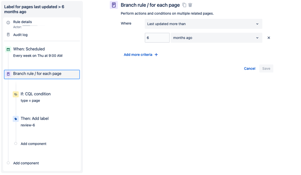

The issue I am running into is that this rule does not run at a global level.
The ideal state would be that when a page has not been updated within the last 6 months the label "review-6" is added to the page.
The rule runs "successfully" but no labels are added to the pages. Has anyone run into a similar problem?

First off, you could remove the If: CQL condition since the branch will only return pages. Second, take a look at the audit log and see were the automation stops, I have a hunch that it may stop on the if condition.

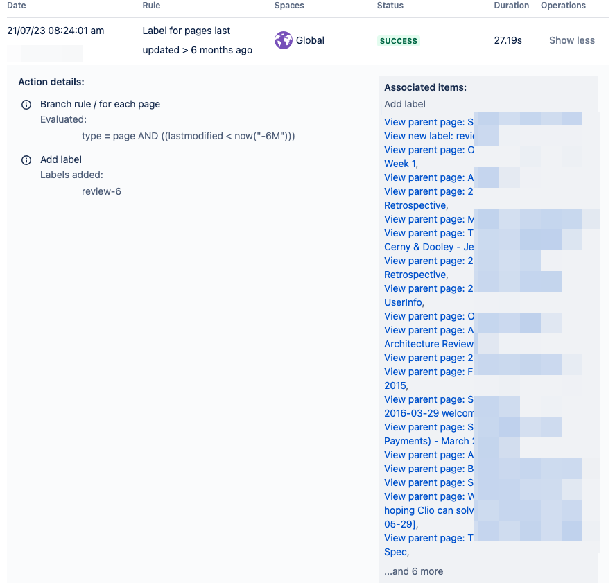

franklin.orellana.arriola July 21, 2023
The odd thing is that the rule is not "failing" in the audit log but the label is not added to any pages.
