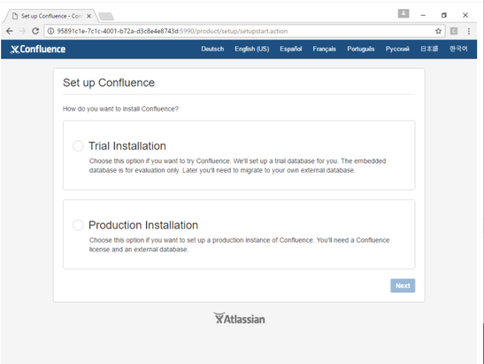

However it seems for confluence specifically that running `atlas-mvn verify` does not load any test data, and my ITs are blocked at a "select database type" page.
This is only an issue for confluence, all other products seem to load typical plugin defaults.
JIRA loads fine
Confluence wants full setup
