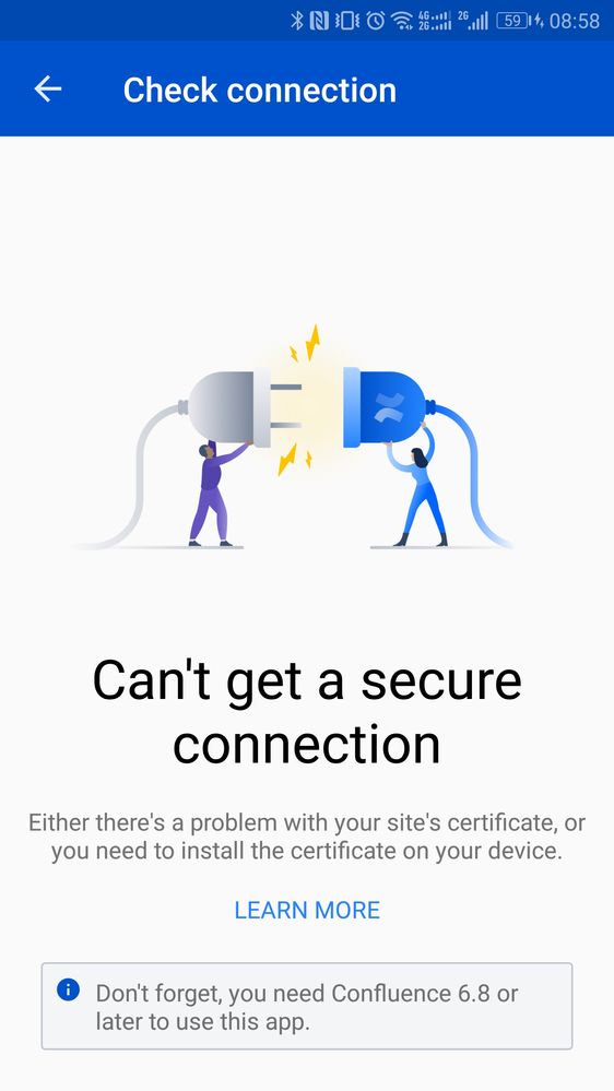

We tried android app to connect our confluence-server ,also show can't get a secure connection, we have tried to install the cert but still doesn't work, our server has a public cert and trusted by default, so IOS version can directly use the app.
It seems that the app haven't tried to connect to the server at all.
I tried to use the latest version 0.1.40  on two different phones,one is HuaWei and another is Xiaomi
Android version is 8.0
Anyone can help?

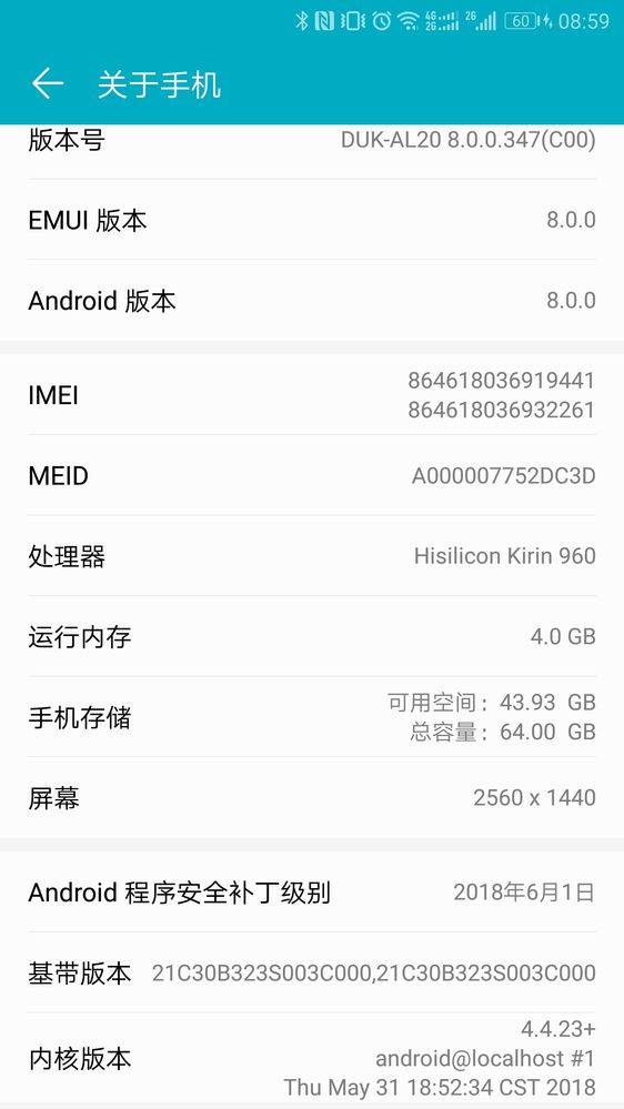

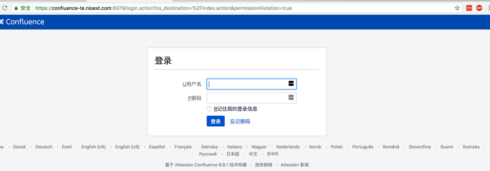

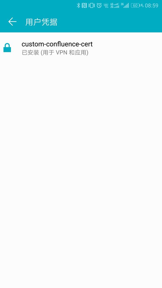

Thanks for the quick reply.Below is some snapshot.
Sorry for all Chinese part since most our users are Chinese.Our website has a regular cert from godaddy so I don't think we need install any cert on mobile device.You can see we visit the https link directly through chrome on the computer show security icon.Also for IOS devices,the app works well.But Android version it always show problem,Both Huawei and Xiaomi we tried.To check I installed our cert on my phone,but nothing changed.It seems like the android version didn't try to connect the website at all then directly show cannot get a secure connection.
