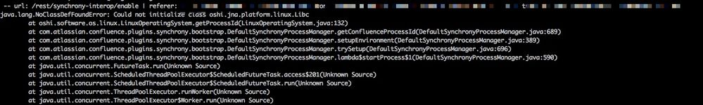

hello,
When I updated the confluence to 6.13.7. Collaborative editing cannot be started. Error not initialize class oshi.jna.platform.linux.Libc, I am using docker to upgrade. based on Atlassian/confluence-server: 6.13.7-ubuntu-18.04-adoptopenjdk8
Has anyone seen this error before?

Sorry, I replied so late, I tried to use your method, but I found that there is no such file in my temp path. This is my error log, please check it out.
2019-10-22 19:30:44,245 INFO [Long running task: Restart Synchrony Task] [plugins.synchrony.bootstrap.DefaultSynchronyProcessManager] startup Starting Synchrony and enabling Collaborative Editing
2019-10-22 19:30:44,270 INFO [synchrony-interop-executor:thread-1] [plugins.synchrony.bootstrap.DefaultSynchronyProcessManager] isSynchronyProxyEnabled proxy port present: false
2019-10-22 19:30:44,270 INFO [synchrony-interop-executor:thread-1] [plugins.synchrony.bootstrap.DefaultSynchronyProcessManager] isSynchronyProxyEnabled app config synchrony.proxy.enabled: true
2019-10-22 19:30:44,274 ERROR [Long running task: Restart Synchrony Task] [confluence.util.longrunning.ConfluenceAbstractLongRunningTask] run Long running task "Restart Synchrony Task" failed to run.
-- url: /rest/synchrony-interop/restart | referer: http://xxx/admin/confluence-collaborative-editor-plugin/configure.action | traceId: 00135f9297d088fc | userName: lanfeng
java.lang.NoClassDefFoundError: Could not initialize class oshi.jna.platform.linux.Libc
at oshi.software.os.linux.LinuxOperatingSystem.getProcessId(LinuxOperatingSystem.java:132)
at com.atlassian.confluence.plugins.synchrony.bootstrap.DefaultSynchronyProcessManager.getConfluenceProcessId(DefaultSynchronyProcessManager.java:689)
at com.atlassian.confluence.plugins.synchrony.bootstrap.DefaultSynchronyProcessManager.setupEnvironment(DefaultSynchronyProcessManager.java:389)
at com.atlassian.confluence.plugins.synchrony.bootstrap.DefaultSynchronyProcessManager.trySetup(DefaultSynchronyProcessManager.java:696)
at com.atlassian.confluence.plugins.synchrony.bootstrap.DefaultSynchronyProcessManager.lambda$startProcess$1(DefaultSynchronyProcessManager.java:590)
at java.util.concurrent.FutureTask.run(Unknown Source)
at java.util.concurrent.ScheduledThreadPoolExecutor$ScheduledFutureTask.access$201(Unknown Source)
at java.util.concurrent.ScheduledThreadPoolExecutor$ScheduledFutureTask.run(Unknown Source)
at java.util.concurrent.ThreadPoolExecutor.runWorker(Unknown Source)
at java.util.concurrent.ThreadPoolExecutor$Worker.run(Unknown Source)
at java.lang.Thread.run(Unknown Source)
