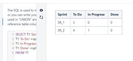

I have a table to track jira task based on their status as below.
The inner table-transformer is to get the numbers properly for each status column. I use split function to retrieve the numbers. (eg: T1.'To Do'->split(" ")->0 AS 'To Do')
The outer table transformer is to add a total column that sums up each status column. But the output adds decimal points to the total column, i dont know why.

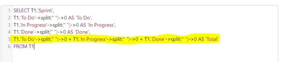

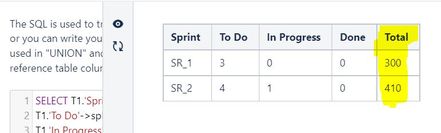

@Katerina Kovriga _Stiltsoft_ I tried to combine two table-transformers into 1 by the adding below yellow query, but it seems to be working as string concatination. How do I get this to work as integer addition?
Try this SQL:
SELECT T1.'Sprint',
T1.'To Do'->split(" ")->0 AS 'To Do',
T1.'In Progress'->split(" ")->0 AS 'In Progress',
CAST((T1.'To Do'->split(" ")->0) AS INT) + CAST((T1.'In Progress'->split(" ")->0) AS INT) AS 'Total'
FROM T*
Adjust it to the third "Done" status, I have the two statuses.
