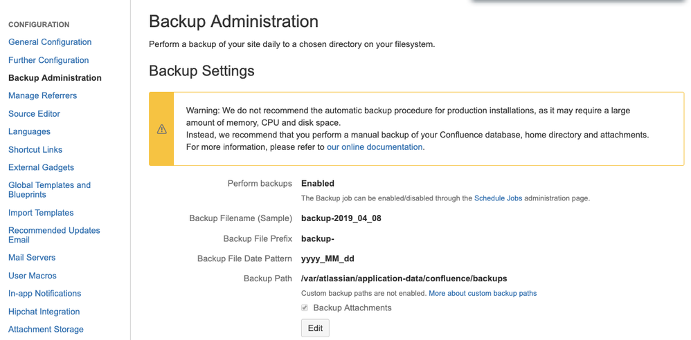

The backup file itself is a result of the daily scheduled backup through cron - configured in confluence's admin interface.
Backup Administration:

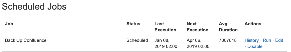

Scheduled Cron:

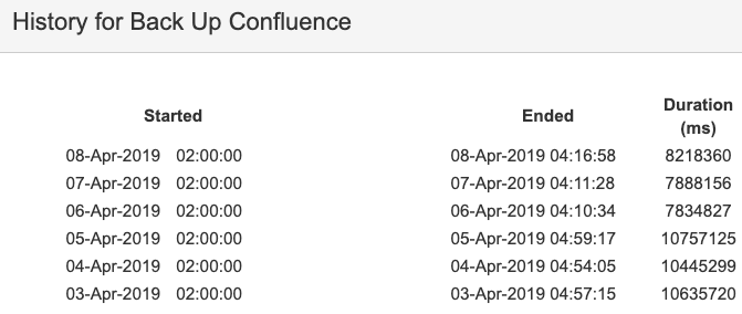

History:
Correct, the exportDescriptor.properties file is completely missing from the zipped backup, and I'm as confused as you are.

Thank you for your help Shannon. I was able to figure out the problem. The Confluence instance we have is large, and the scheduled backup would not be completed before the scheduled cleanup would begin. Thus while the temp directory was being used as a staging place for the backup bits, the scheduled housekeeping started deleting files from the temp directory. So when the backup process finished, it was missing files from the zipped file.
