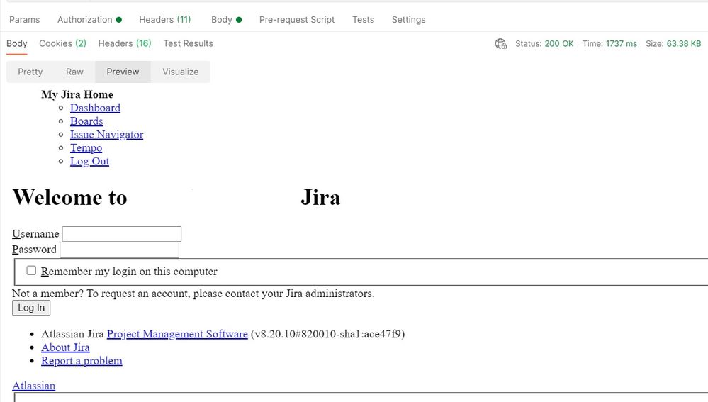

@Andy Heinzer After changing "Type" from basic to bearer now I can get 200 OK but in response getting whole html page source code which cantans lot of hyper links along with login page asking username and password.
Any hints?
What endpoint are you calling in your REST request? Perhaps it might help to see the command you are trying to run. But I would recommend that you not post your actual PAT or your actual URL here in Community, as this is a public site.

Based on the response of the login page, it looks like your authorization is failing. The payload looks like you're trying to do a POST to that endpoint. While you can start there, I tend to suggest trying to do a GET from that endpoint of a known existing issue that your account has access to. This tends to be a bit easier to make sure that you can get back the expected output before trying to create a new issue.
I recommend trying to follow the steps in https://developer.atlassian.com/server/jira/platform/basic-authentication/ to encode your credentials in the base64 string and then pass that encoded string as part of an authorization header. If this is done correctly, you should get back the issue details in a json format.
