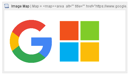

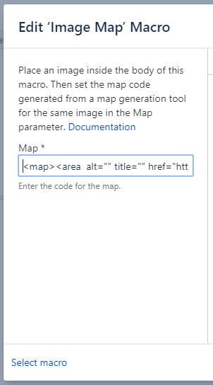

What you are looking for is an image map. There is nothing in Confluence that can do an image map natively, but you can create a user macro that would allow you to do it. Here is code I created a little while back for this purpose. You will still need some utility to create the image map for you, but once you have the map html you can put it into the user macro map parameter along with the image in the body of the macro. There are many tools that can do this for you, but if you just want a web tool for this you could do it with http://www.image-maps.com. See the below screenshots for usage example.
Macro Name:
image_map
Macro Title:
Image Map
Macro Body Processing:
Rendered
Template:

## @param Map:title=Map|type=string|required=true|desc=Enter the code for the map.

This is the map code that I put in above.
<map><area alt="" title="" href="https://www.google.com" shape="poly" coords="79,26,53,31,30,46,15,69,10,95,15,121,30,144,53,159,79,164,105,159,128,144,143,121,148,95,143,69,128,46,105,31" style="outline:none;" target="_self" /><area alt="" title="" href="https://www.microsoft.com" shape="rect" coords="173,23,310,165" style="outline:none;" target="_self" /></map>
