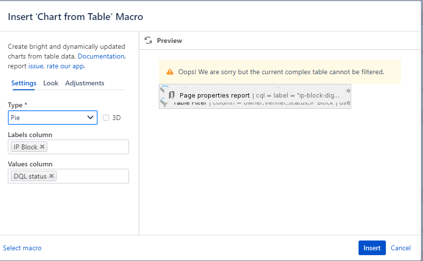

Hello, I tried to wrap the page properties report with "the table filter macro" and on top of it I am using the "charts from table" macro to create a pie chart. However, I am getting the following error.
I do understand that the "table filter" macro is different from the "Table Filter, Charts & Spreadsheets for Confluence". I want to know if the option I am trying will work or not.
Could you help on this.

Hi @Venkatanathan Ramamurthi ,
As we see from your screenshot, the Table Filter macro gives an error that the source table can't be filtered and instead of a proper table coming from the Page Properties Report macro we see its code snippet with the macro settings.
So, please refer to our support to look into the issue closely.
The portal is confidential, so please attach the screenshot of the table coming from the Page Properties Report macro (in a published state without any other macros).
Also attach the page storage of your master page with the Page Properties Report macro and one of the pages where the Page Properties macros are located. To get the page storage, go to the upper right corner of the page -> menu ... -> View storage format. If you don't see the option, please ask your Confluence administrator to do it for you.
And if you are not on Confluence Cloud but on Data Center, please define the current version of the app as well.
