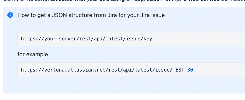

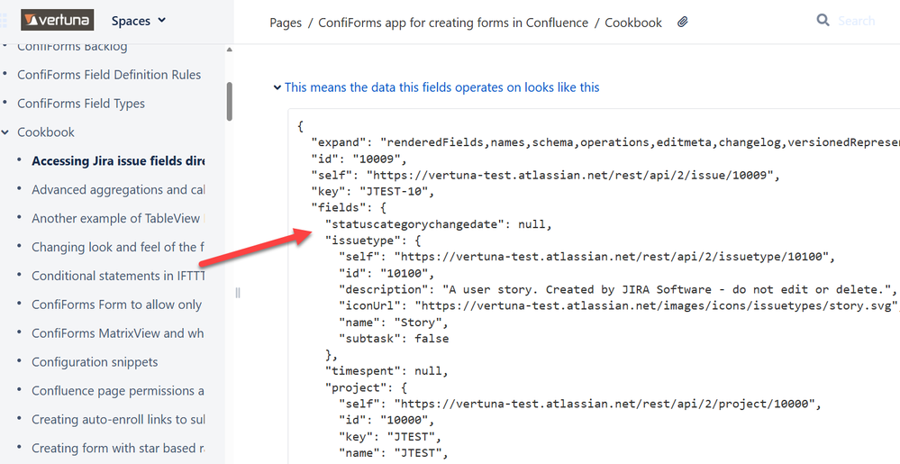

So, WHAT JSON gets returned for the Jira issue and for the field of interest in particular, as per advice in the https://wiki.vertuna.com/spaces/CONFIFORMS/pages/42926274/Accessing+Jira+issue+fields+directly+from+ConfiForms+using+Jira+issue+field ?
I understand, but I am not sure how to get the JSON returned, are you taking about the TableView specific format? or how can I send you this? I do see this instruction:
"And anything you se here can be accessed through the ConfiForms Field macro, setting field name parameter to a "navigational expression"", but this is the first time I deal with this use case, and I am not familiar with how to set the field name parameter to a navigational expression.
Any help will be great,
Well, there is a very clear instruction of HOW to get the JSON structure that is getting returned for the Jira issue
well, I did follow those instructions, but I am not getting any data similar to what you have in the article. If I search for my custom field in reference, yes, I find it, but I don't see any JSON like structure. Is there another way you can help me here? again, my TableView field configurations are working correctly with other Custom Fields, the only one not working is this Cascading field type.
OK, what have you "followed"? have opened the URL in a browser (the format you can see above and on the earlier linked page)?
yes, that is what I did, but with my server, and my issuetype Jira Key
I did, but nothing in the format of the article. So, I don't know what to send you regarding this specific Cascading Jira Custom Field
What do yo mean nothing? No response?
I do get a response, but the data is not like what you have in the article:
What do you get in a response? a JSON?
I am not sure what to send you, so you can help me. Also, you do have information about Cascading fields in a Venture article, but I have tried many combinations and none is working:
This is a public formu, if you are not secure to share the response of the request here then opena support ticket with us and SEND the result of the request that you get
yes, I can't share the response here. Would you mind sending me the link to open a support ticket with you?
