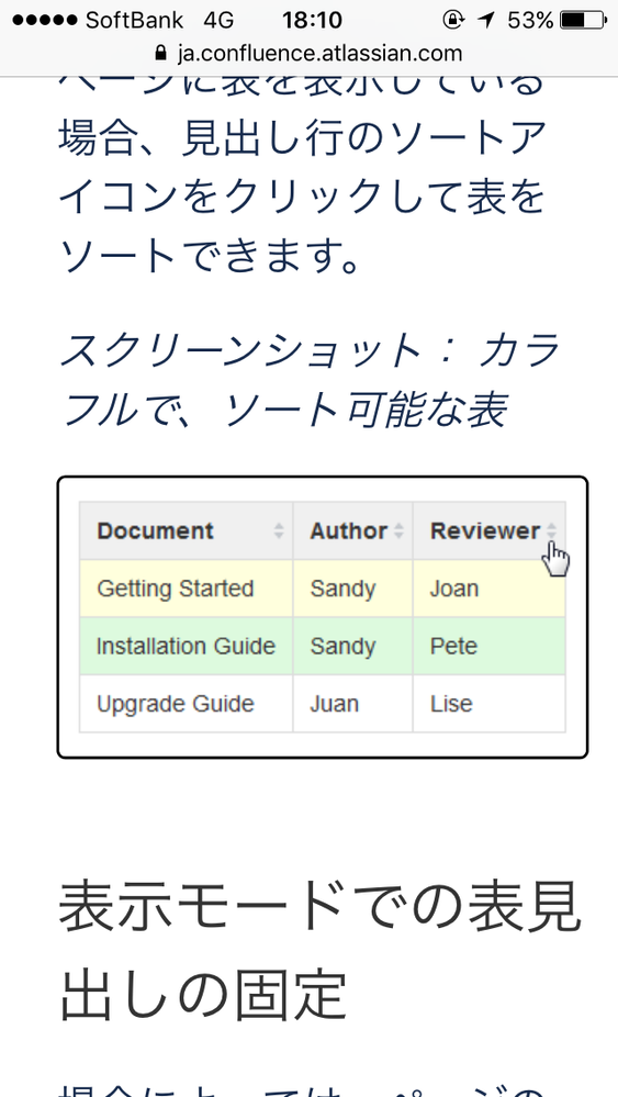

吉野咲耶 April 6, 2018
I would like to sort the table like your description page's picture.
Could you tell me a procedure how to do it ?

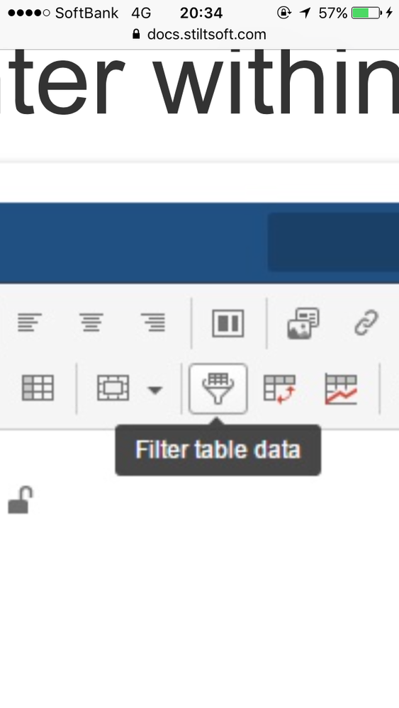

Andrey Khaneev _StiltSoft_
April 6, 2018
These icons come from Table Filter and Charts app. This app doesn't change the way of sorting. But Table Filter macro can be used to set default sorting order and it enables tables (that are inside the macro) sorting in the editor (with Ctrl+Click).
April 6, 2018
Thomas, if you are interested in this app, you can play with it here.

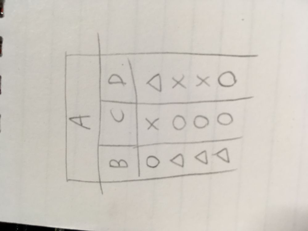

Do I need to remove a sell of A for sorting "○"?
April 6, 2018
Yes, you need to remove cell A to be able to sort by columns B, C and D.

Thomas Schlegel
April 6, 2018
What do you mean by "description page's picture"?
吉野咲耶 April 6, 2018
Thank you for your quick response!
I meant it like the picture of below.
I would like to use the filter for narrowing down information in the column.
Thomas Schlegel
April 6, 2018
This kind of filter is standard in every Confluence table.
It appears, if your table has column headers and the table cells are not merged.

吉野咲耶 April 6, 2018
I see...
How about the type of bellow?
Shold I cancel merging of A?
e.g.) When I would like to sort " ○" from a column of C.
Thomas Schlegel
April 6, 2018
Yes, if you want to sort this table, you have to remove the line A and define the line with the cells B C and D as the header of the table.

And after that, should I use this icon?
And then should I chose "drop down filter" ?
Thomas Schlegel
April 6, 2018
Oh, you have a special table app installed? This is not the standard Confluence table editor.
