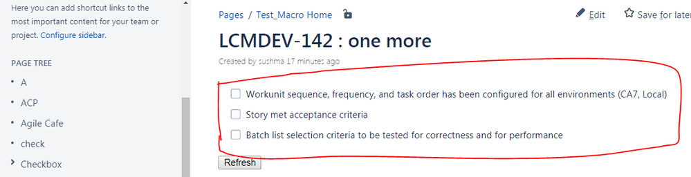

Sushma September 20, 2019
Hi @Jonny Carter @Carsten Hilber
I have a similar requirement, On clicking the "Button" it should trigger a REST api of jira Server and also it shoul send the body of entire page and  pageTitle.
is it possible to do that ?
I tried but, onclick() event is not triggering the REST API of jira
Please respond..

Sushma September 22, 2019 edited
Hi @Jonny Carter
In jira post function I have added the below code to achieve the page creation in confluence (using page template) from jira server.
import com.atlassian.applinks.api.ApplicationLink

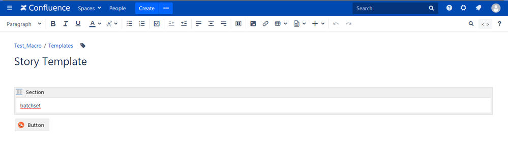

In the above code ,I am passing 4 paramters:
1.page title
2.page template id
3.issue key
4. set of values that needs to be appear in the confluence page as checklist values (which is shown in the below screenshot)
To receive the above parameters I created the REST endpoint in confluence using the below script.

My template format is as shown below
here what i am doing is I am replacing the "batchset" value with the "body" which is received from Jira.
Using the above code I am successfully able create a page in confluence.

So to update the page , I created a button on the confluence page. "My requirement is on clicking the "Refresh" button I want to update the existing confluence page with the newly added values ".
I am not getting any way to update the page" .
Do you have any idea to achieve it ?"
Hi @Jonny Carter
I am using script macro to create a button in confluence page.
On clicking the button it should call the REST api of jira server to update the existing confluence page with the new values .

That helps a lot, @Sushma, thanks! This is an interesting use case.
So, you could potentially do it as you are, using a scripted macro that adds a button to the page... when you click it, it refreshes.
A better idea, I think, would be one of two paths:
1. Create a script macro that simply pulls & renders the information you need from Jira on the fly. It's always up to date that way. The downside is, no one can make edits to that content, as they can with your current solution. Depending on your use case, that might be a benefit, though.
2. Create a listener in Jira that, on the IssueUpdated event, calls a separate REST endpoint in Confluence that updates the page, rather than creating a new one.
The second path will probably be the most straightforward to implement with your current setup. All you'd really need to change would be writing a REST endpoint in Confluence that updated the page, rather than creating one. That's pretty straightforward. You use the same PageManager.saveContentEntity method you used to create the page, you just need to pass it the page you want to update, rather than a new page object. Since you have a standard format for your page title, you could simply call pageManager.getPage("SPACEKEY", "Page title").
In fact, you could probably bypass writing the Listener in Jira & the REST Endpoint in ScriptRunner for Confluence entirely, and just create a Remote Event Listener in Confluence that listens for the linked Jira instance's Issue Updated event. That said, it might be quickest for you to start with the familiar tool of the REST endpoint.
Anyway, that's the rough outline. If you have some more questions about the details, feel free to ask. It would help to know a bit more about the why of this use case. I understand a comment thread can get a bit crowded, so if you need to start a new question where you lay out your use case from first principles, that's fine. You can @mention me. :)
