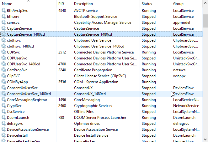

Actually, I installed Confluence as a service, but I do not see it under Services.

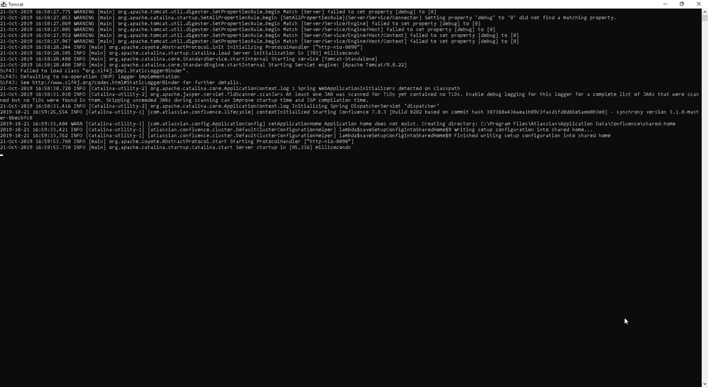

No logs were created in both folders.
I ran the start-confluence.bat over the cmd and Confluence was installed.
