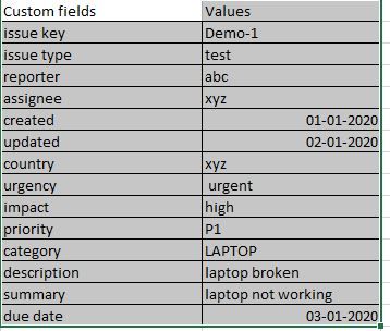

Can some please help how can i create the below table in confluence using JQL
I bascially want to capture the value of custom fields presesnt in issues along with its value .
table format required is below
Please advise.

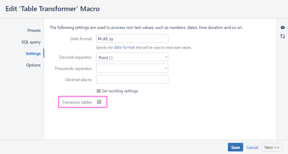

Mon 2-1.png Choose the Transpose tables option:

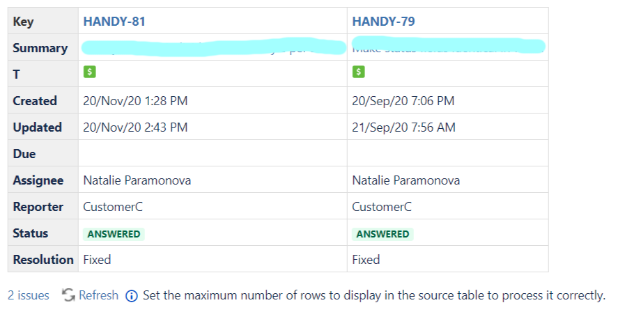

Mon 2-2.png And get the result:
Mon 2-3.png Hope this helps your case.
