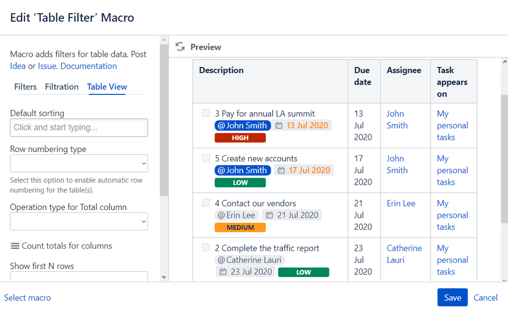

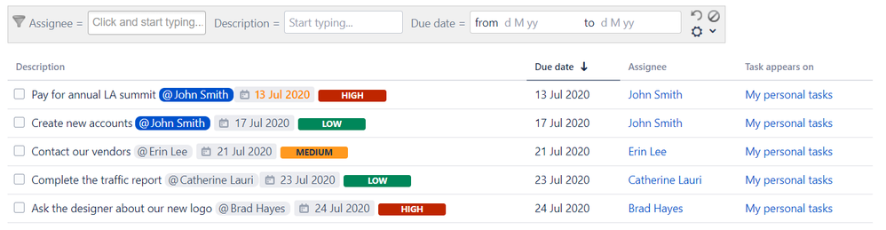

Standard Task Report:

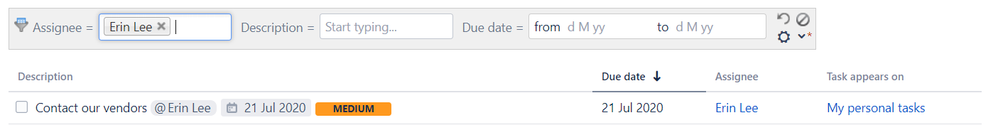

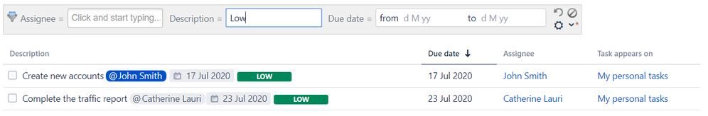

Paul 1.pngTask Report&Table Filter:Paul 2.pngFiltering by assignee:Paul 3.pngFiltering by description (priority):Paul 4.pngNote that our filter works with statuses and recognizes their text successfully.

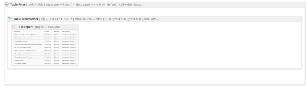

At first, wrap the Task Report macro in the Table Transformer macro (no changes in the settings required). Now all the fields are sortable.
Then wrap both macros in the Table Filter macro where your filters are set.

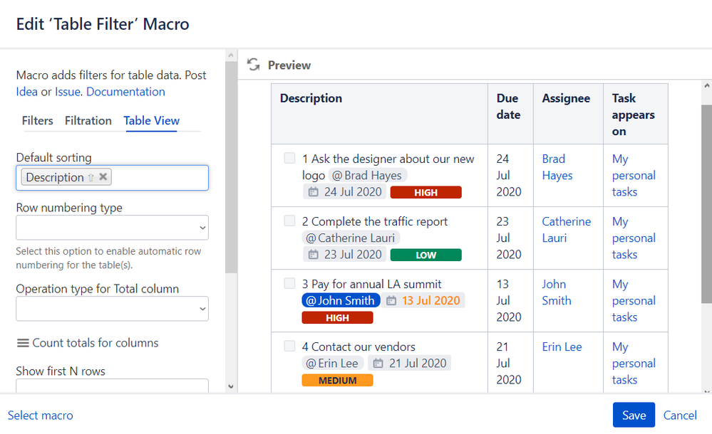

Paul 5.pngThe second step is to add the default sorting to your Table Filter macro.
Paul 6.pngPaul 7.pngAs you can see, now our sorting works just fine.
