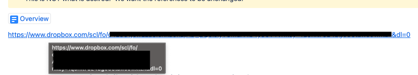

I use Dropbox extensively. It used to be that if I pasted in a Dropbox link (to any file type), it would turn into a smart link. Lately, it has quit doing this, it just appears as a basic link (only option is "edit link"). I would REALLY like to have the smart links working.
I have discovered the new(ish) /dropbox macro. Even if I use this macro, the resulting link is an inline link and is NOT a smart link.

No, I don't see this. If I select "Edit Link" I only get the pop-up with the URL and an option to type in the text to display (this is the same as it has always been)

I only used the "dropbox macro" to TEST if it behaved differently than just pasting in the link. It does not - and it's a MUCH slower way to work. I generally do NOT use the dropbox macro. I generally use this workflow:
1. from the Finder, right click on the file of interest and select "Copy Dropbox Link..."
2. in Confluence, Command-V paste in the Link
This USED to work and convert to a smart link. Now it is just showing as an inline link

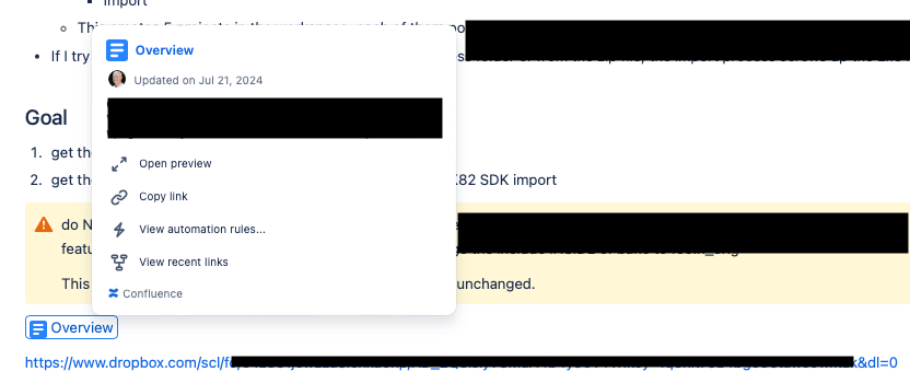

(in this case, a link to another Confluence page)
Hover cursor over link to get pop-up meu
Single click on link to display pop-up menu
Hover cursor over link to get pop-up additional information

You mean that when you are pasting the link to a Dropbox file you don't have this rendering ?
Correct, when I paste a link to a Dropbox file I get the full URL appear, in blue and underlined as an active link.
If I paste a Confluence link, I get the above view
