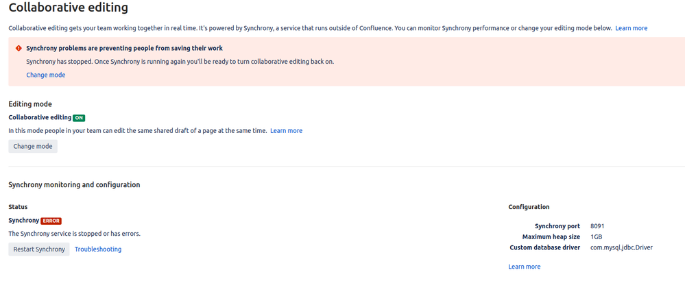

I have uppgrade from
atlassian-confluence-7.4.0 => atlassian-confluence-7.6.0
I could run confluence but the problem with synchrony:
logs/grep:2020-07-24 14:10:36,431 INFO [http-nio-8090-exec-6] [plugins.synchrony.config.DefaultSynchronyConfigurationManager] retrievePublicKey [Collab editing plugin] Could not retrieve public key for real-time collaboration service at http://localhost:8091/synchrony/jwt-key with exception: Connect to localhost:8091 [localhost/127.0.0.1, localhost/0:0:0:0:0:0:0:1] failed: Connection refused (Connection refused)
I use apache as reverse proxy.
I can reach localhost:8090 yes.. but even there I can't restart synchrony!

I have disabled the apache configuration so I don't have reverse proxy.
The port 8091 is not blocked in the server..Synchrony still doesn't work
I have changed in /home-directory/bin/setenv.sh to increase heap dump for synchrony:
CATALINA_OPTS="-Dsynchrony.enable.xhr.fallback=true ${CATALINA_OPTS}"
CATALINA_OPTS="-Dsynchrony.memory.max=2g ${CATALINA_OPTS}"
but I still see that heap size= 1gb
I have done this: ssh -N -L 9998:localhost:8090 cyg17.netset.com
then navigated to http://localhost:8090 I could reach conflunce server without problem.. I think confluence doesn't start totally, because it doesn't produce 8091 port when I netstat -pnlt | grep 8091 I find nothing

1- Now, I have confluence server on two CentOS servers. I created new server for test purposes. Firstly, I installed confluence 7.4 without reverse proxy (Apache wasn't installed at all on the server). In this case synchrony works fine.
2- Then I upgraded confluence server from 7.4 to 7.6.x where x is - and 1. (Apache still not installed on the server). In this case synchrony doesn't start.
3- Then I downgraded confluence server from 7.6 to 7.4 and installed Apache (reverse proxy). In this case confluence and Synchrony works fine.
4- Then I upgraded confluence server again from 7.4 to 7.6.x. In this case Confluence works but Not synchrony.
Would you please be able to provide that to me?
https://community.atlassian.com/t5/Confluence-discussions/atlassian-confluence-7-6-X-BUG/m-p/1445359
