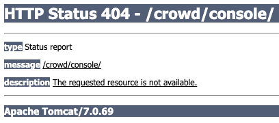

I'm attempting to create an instance of Crowd, mirroring its Live counterpart for our Testing environment. I've cloned the container and changed some few key configuration, as described below. The problem is that while the URL loads this test version of Crowd, clicking "Set up Crowd" gives the following error:
The overall landing page looks oddly plain too, without nice-looking buttons and formatting, if that's any hint.

Mario Staykov October 16, 2019
In the end, even after strenuous comparison to similar resources that are served (such as the demo-webapp, located next to crowd-webapp), I couldn't find anything indicative of the problem.
I solved it by avoiding it - I just installed (simply unzipping and placing alongside) the newest version of Crowd 3.7.0 and this issue did not appear. Perhaps nobody has to deal with it unless they're running ancient versions :)
