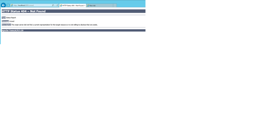

HTTP Status 404-Not Found.pngI was using Crowd 3.0.2 and noticed there is a newer release (Crowd 3.1.1) tried to install this version and got the above error message.

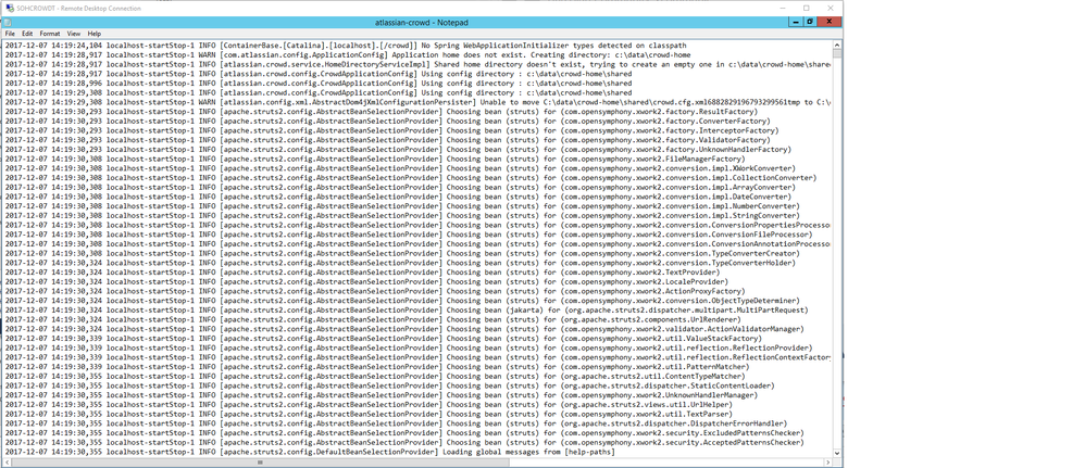

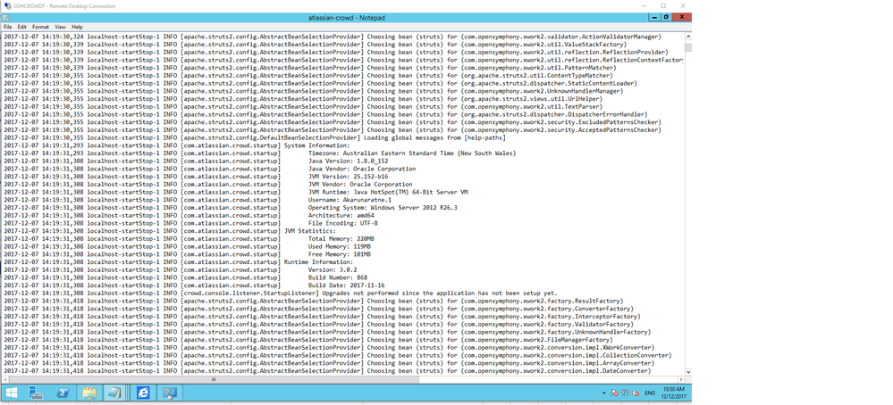

The C:\data\crowd-hone\logs\atlassian-crowd has log details on 2017-12-07 which relates to crowd version 3.0.2
---------------------Part 1 -----
Ayesha Karunaratne December 11, 2017
Log file is very long. I have give some from the start and entries from the end. All these relate to 07/12/2017. (i.e. version 3.0.2)

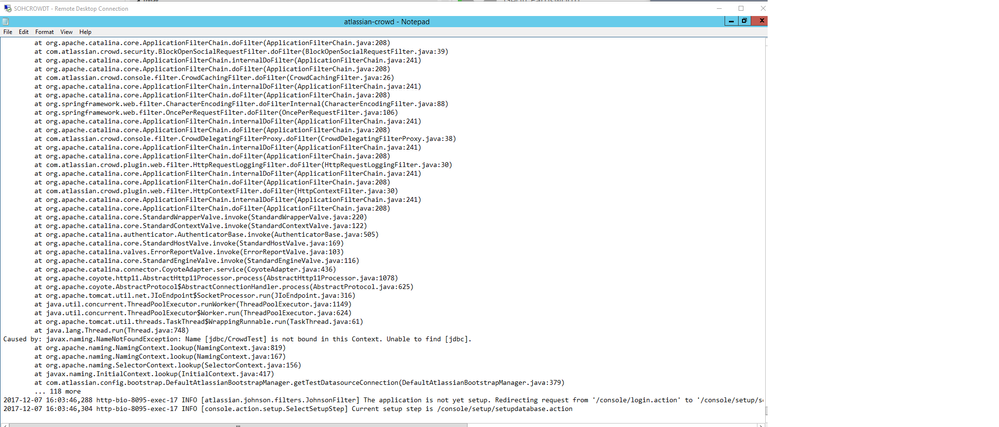

From the last log entry you've shared it seems that jdbc/CrowdTest jndi context is not defined in your server.xml which might be the cause why the Crowd application is not starting up.
Could you check the <crowd-install>/apache-tomcat/conf/server.xml contains jdbc/CrowdTest?
Could you also share why are you using jdbc jndi resource rather than jdbc connection?

I am doing a new installation. ( Not a upgrade). I have installed JAVA8U152. I am trying to use the wizard. http://localhost:8095/crowd
Cannot get to the first screen. says
'Page cannot be displayed' yesterday it said 'HTTP Status 404-Not Found'

Ayesha Karunaratne December 14, 2017
I manage to install crowd 3.1.1 using the wizard successfully.
Unable to invoke crowd. using either of links
http://localhost:8095/crowdtest/
http://SOHCROWDT:8095/crowdtest/
SOHCROWDT = server on which Crowd is installed

As for your current problem, by default Crowd should be accessible on 8095 port and context root /crowd. For example:
Did you modify the context path in the
<Crowd-Install>/apache-tomcat/conf/server.xml
Or maybe did you modify Base URL in the setup wizard?
Right now it is hard for me to understand why so you expect Crowd to be running on /crowdtest context path.
Please note that by only changing the base url in the Crowd's setup wizard you actually do not change the url you would normally access Crowd's console in the web browser.
The base url defined in the setup wizard, which can also be changes in Crowd console config, is used for things like for example generated links for user's password reset.
