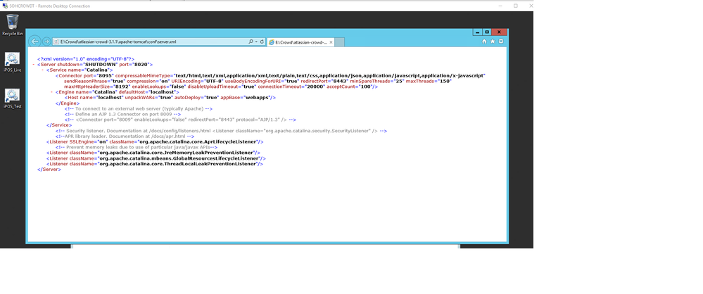

I did not change the server.xml. Server.xml is attached herewith
Any assistance in solving this issue is appreciated.
